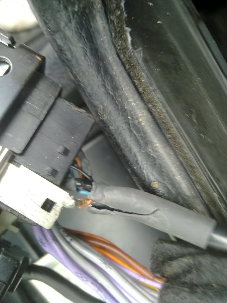

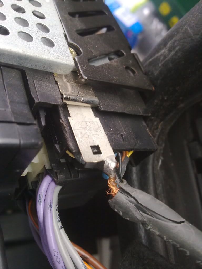

right ive now found out its definatly the connections in the back of the stereo but i dont know what, i thought the metal tab that goes in the back of the stereo was the speaker connector, but when i took it out it didnt make a difference, so whats it for? i took some pics

and its not like i can buy a new headunit to fix the problem as this is the connector that goes into the aftermarket headunits isnt it?
Re: Need help with standard stereo
No, it's Pug-specific, it looks rather like the data feed to screen, bsi, stalk - not something you want to mangle any further. I+d think the bare wire is where all the other shields from the coaxial cables are bunched together and earthed down to the stereo. The one below looks more like the speaker feeds.

yh but the whole lot of them plug into an adapter that goes into an aftermarket stereo doesnt it, well maybe apart from the one that contrals the display etc, but its the speaker ones that are a prob, and theyd connect into a new headunit, so i need to find out what it is and fix it, they look ok visually

You got a D8 or D9 Jason? That connector does look a bit mangled!
You say it is defintely the connector; does it right itself when you wiggle it? Could also be a dry joint on the HU itself...

i got a d8, yh when i press hard on the connector plug it works, ive got it out atm but they all look ok, but you cant see how the solders are is there in the holes in the plug

the ones ive been pressing that make the speaker cut back in are the power leads, i thought they were the speaker plugs, so why would pressing the power cables make the speaker cut in and out?

I've got no idea. Sometimes the answer to a problem is completely illogical but if it cures it then who cares!

We are all here to help each other but you need to do some basic troubleshooting first. Continuity test between the speaker plugs and the radio connector?
