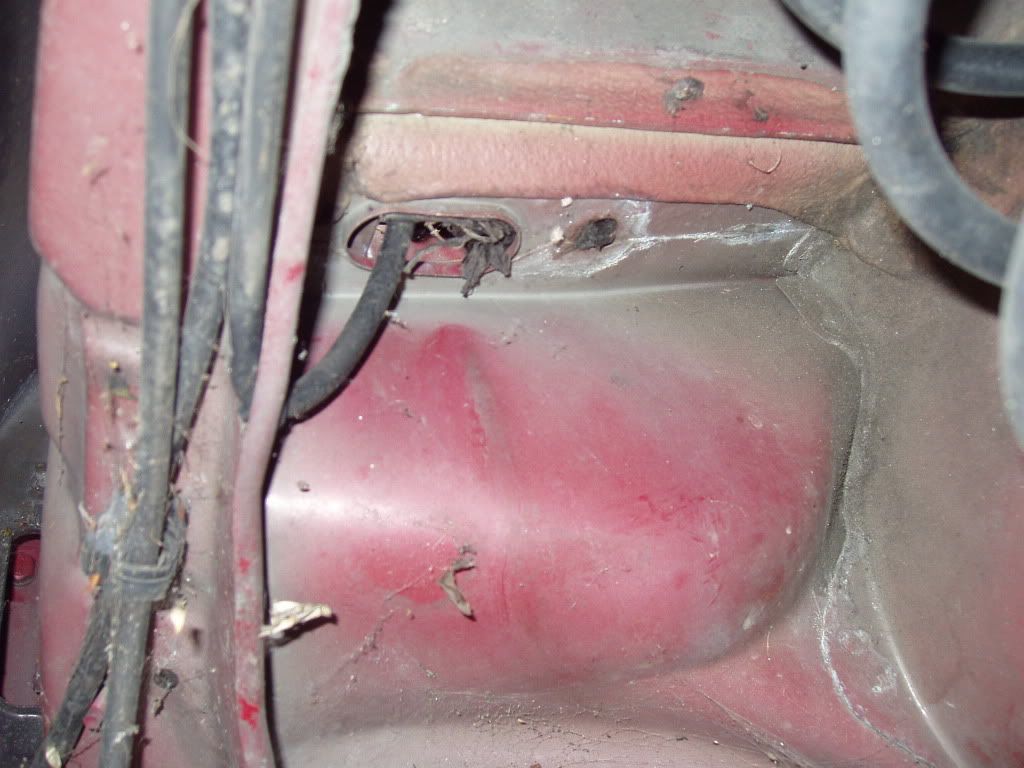

in your first pics, whats that blue cable around the fuse box ? that goes into that black box next to the headlight ? why is it there ?

It was a quick repair for the earth on the throttle position sensor. The rusty bracket had rubbed through the loom and shorted out the wiring.
A temporary repair that lasted 4 years. It goes down the side of that box and joins the earth point below it.

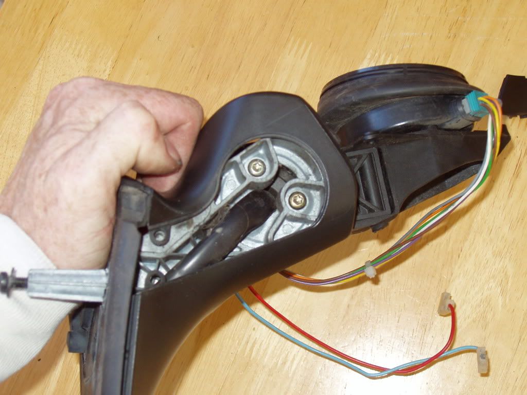

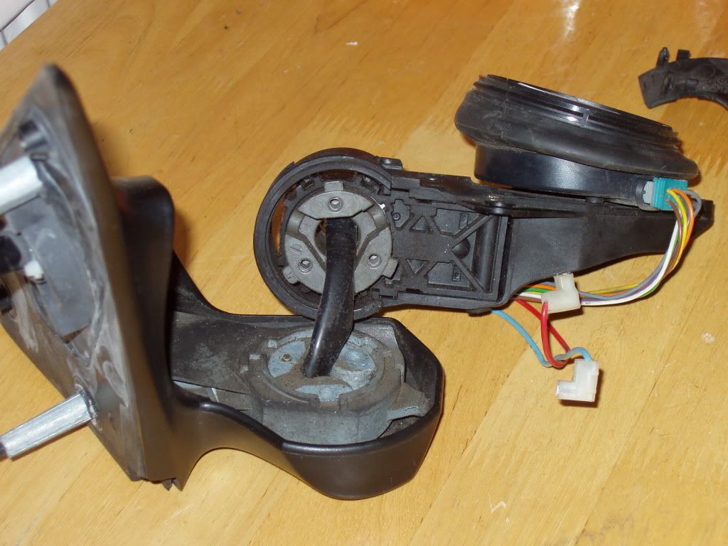

Taking your mirrors apart, most of the screws are torx t20.
There are three fixing the mirror to the door.
After removing the glass,by pressing the wire clip,
there are three screws that hold the surround and motor together.
Once they are out the surround has a clip on the inside of the hinge, out of sight,
a little wiggle and pull straight back and mine separated.
Behind the circular mirror mount, at about the 2 or 10o'clock position is a clip holding the front shell.
Unclip it and rotate the shell forwards 90 degrees and it will lift up off the frame of the mirror.
This is for info only, I can't see any need to do it as these parts, if broken require a new mirror.
There are two gold coloured screws holding the frame to the fold motor/gearbox. Take them out and lift the frame up.
On the underside of the door mount is a clip on panel covering three more screws holding the gearbox to the door mount.
The motor/gearbox looks to be welded or glued rather than screwed or clipped, I didn't try to separate them.

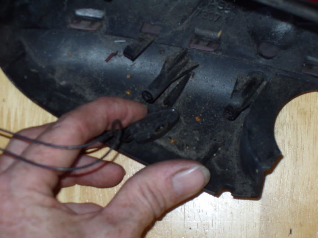

The painted section of the front shell can be separated fairly easily once the shell is off the frame, so you can swap them on replacement mirrors, or for repainting.
There are three flat clips along the bottom, and three taller clips higher up. The top bits are for alignment.

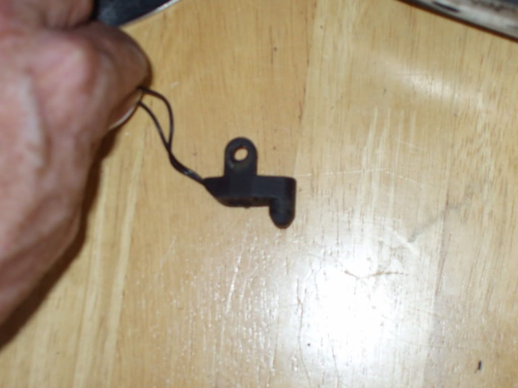

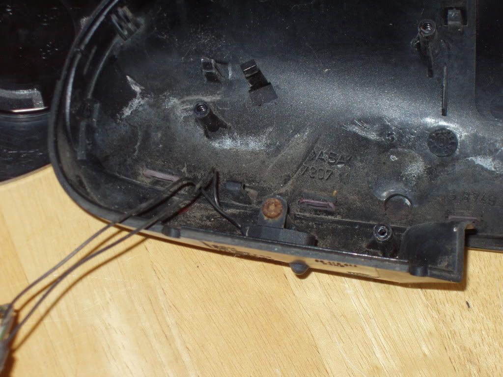

The temp. sensor is fitted in the left hand shell.
Remove the screw.
And rotate the sensor,
to release.
The wiring passes through the hinge,
and the frame, under the rubber pad,

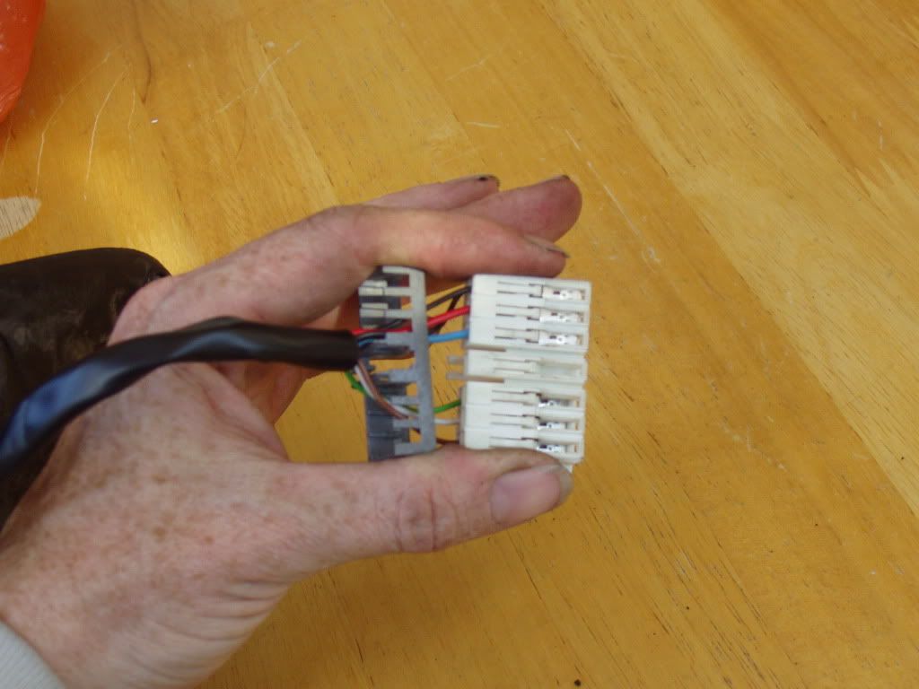

to the plug.

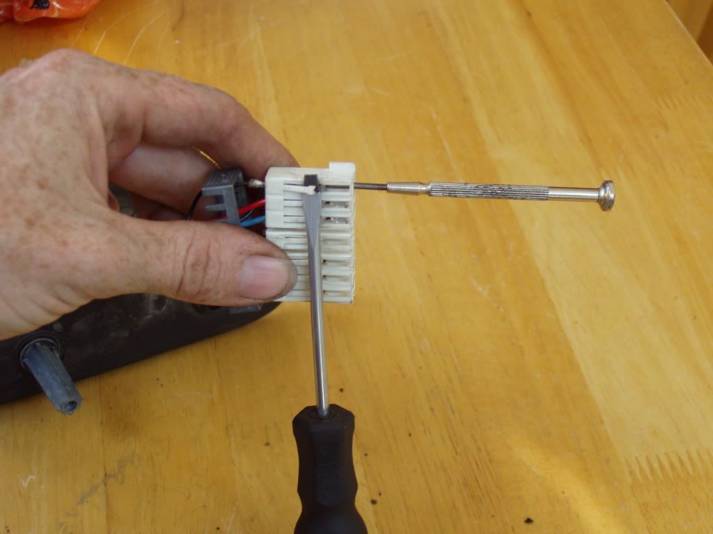

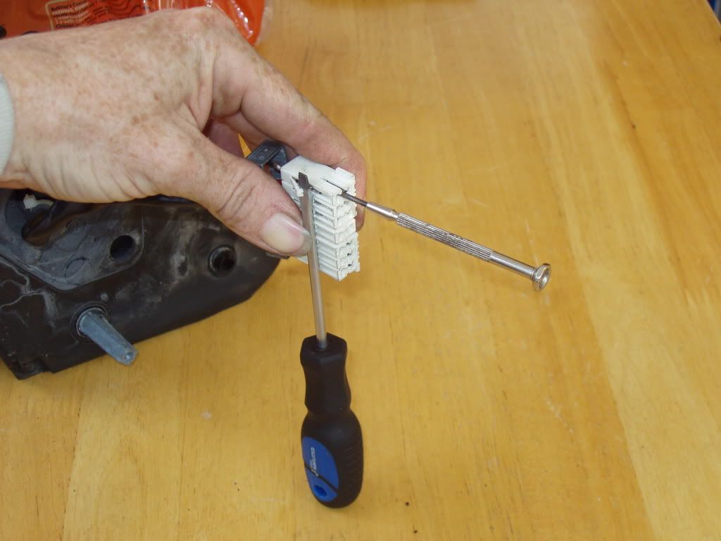

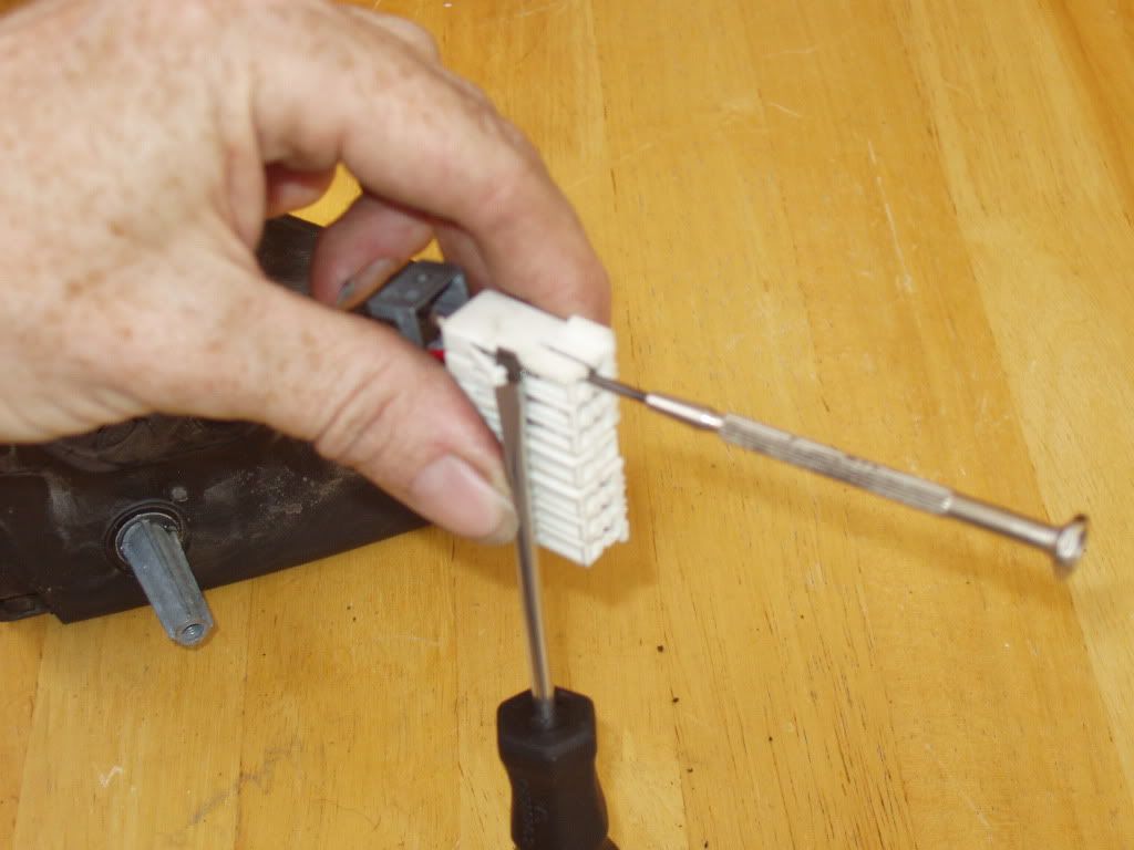

Carefully separate the grey and white sections of the plug, there is a clip on the opposite side to the plug release clip.
Now there are two clips holding the connector into the plug, an easy one on the outside, and the tricky one in the centre.
Gently remove the connector from the plug.
You should be able to carefully unthread the wires from the sleeve.
Reassembly is a reversal of the above!

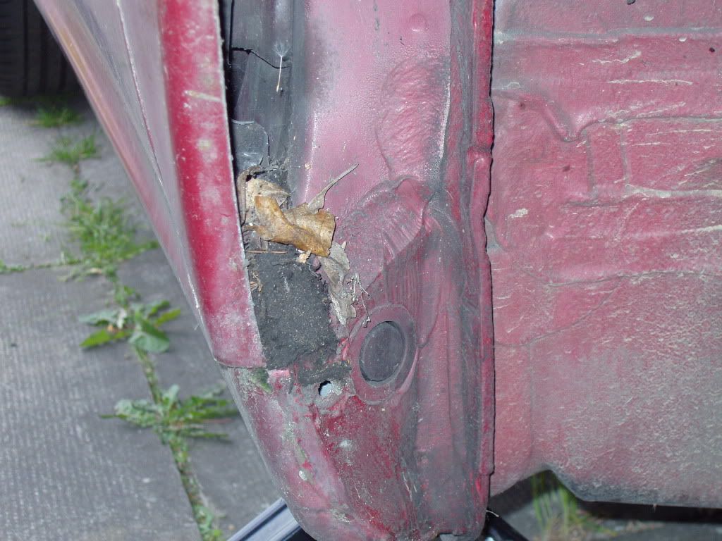

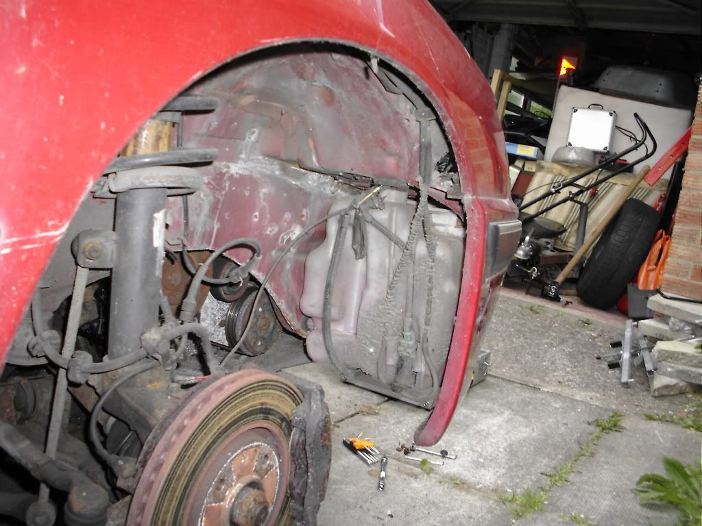

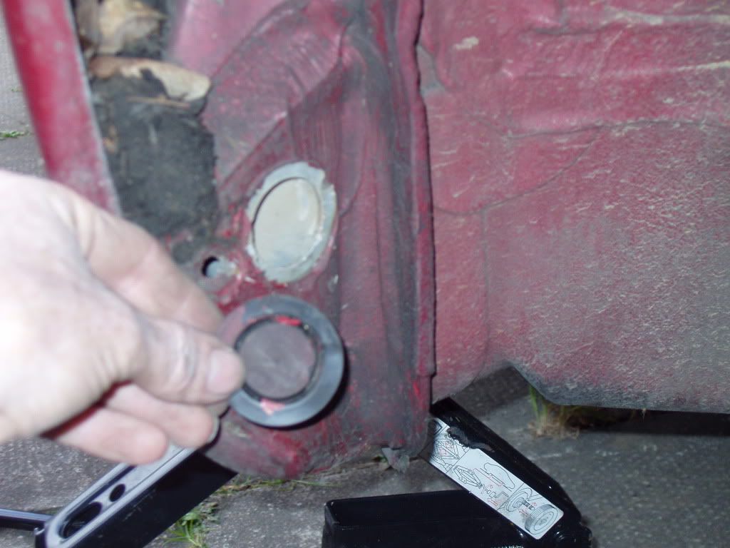

FarmerPug wrote:hi there, can you pop out the sill end holes behind the front wheel arches, just to see how they are taken out and if they can be put back in.
If you see any particular rust traps let me know but i think i found most of them the time i was breaking the car.
Good idea though making a guide as you break it, i regret not taking enough photos.

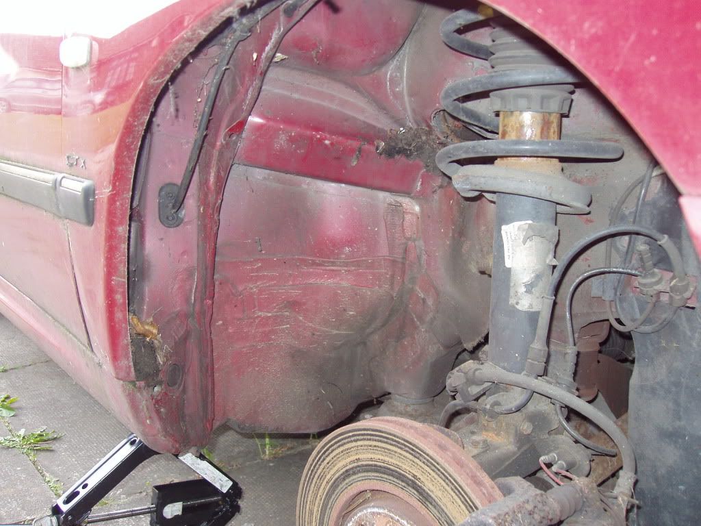

Front arches.

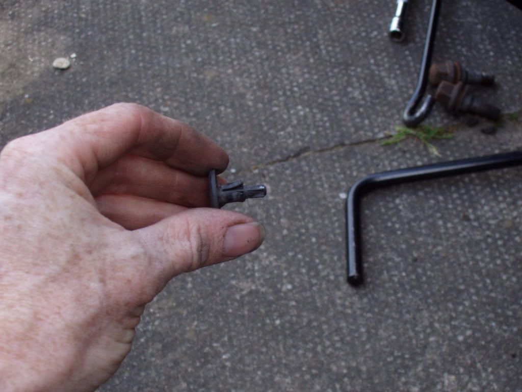

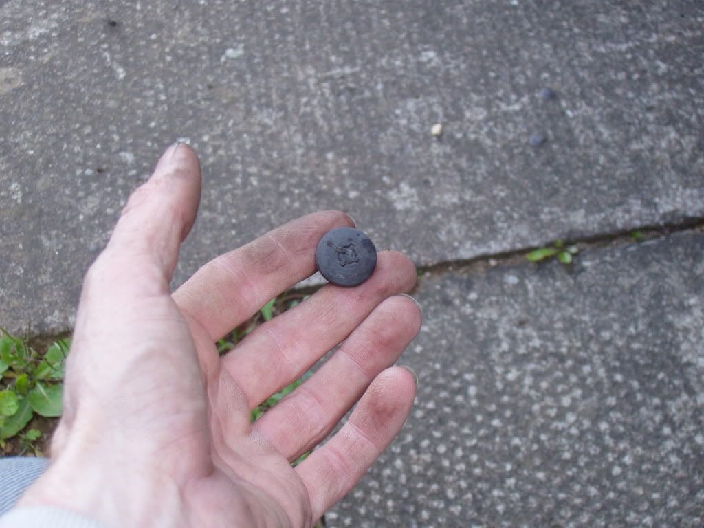

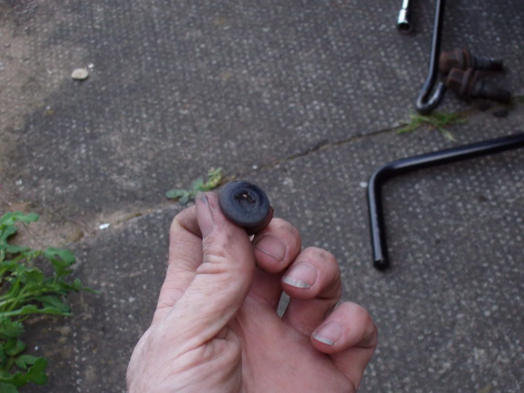

The plastics are mostly held with these.
Push the centre in to release them.
To re-install them, pull the pin out, push them in to the mounting hole and push the pin home.
I find that if you get the bottom of the plastic free from the wing, then you can slide them down to remove them from the car.

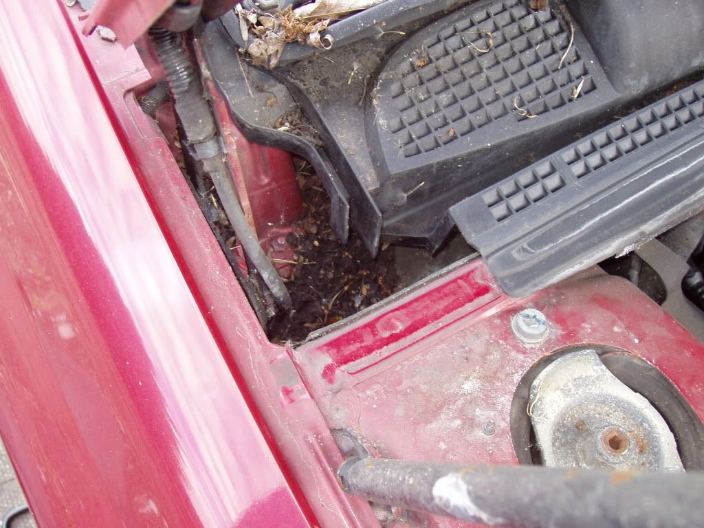

Notice the dirt collected here,
and here,
and the drain hole here from the vent area.

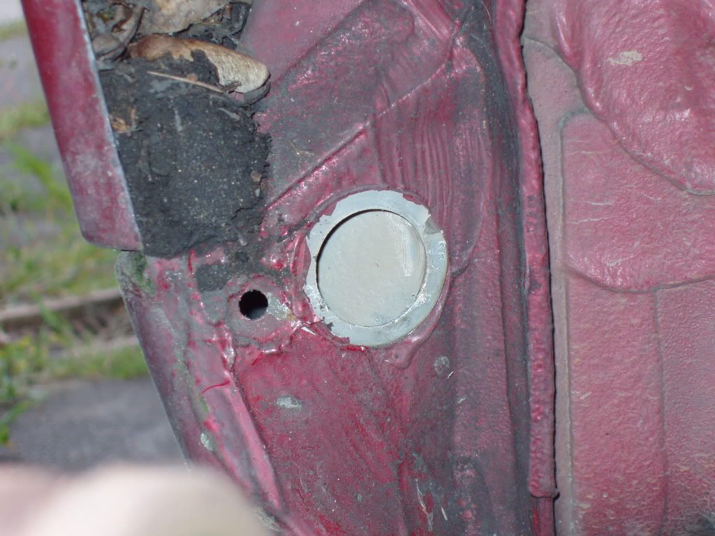

The sill access plug, plastic not rubber, lets you see virtually nothing.
The hole next to it may be more use?

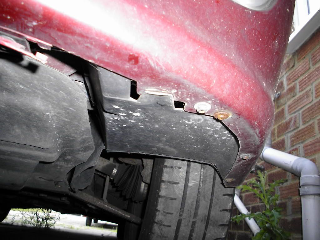

The front half is secured to the bumper with torx screws.
There are a couple of the plastic clips, and very likely some cable ties/zip ties at random places.
Be aware that the ABS and brake pad wear wires are clipped to this section.
The washer bottle is under the right hand side.
It is secured by this bolt and a peg into the chassis rail.
The pump is a push fit into the reservoir, so it can be replaced without removing the tank, and on the estate feeds the front and rear washers.
To remove the tank, disconnect the wiring and plumbing, and unclip the loom from the bottom of the tank. Unscrew the filler neck.
Remove the bolt and swing the bottom of the tank out to release the peg.

stealthe wrote:The sill access plug, plastic not rubber, lets you see virtually nothing.
The one at the other end of the sill is big enough to stick a camera in though :wink:
stealthe wrote:Push the centre in to release them.
Unusually convenient for PSA, the usual sort looses the pin into a box section :roll:
