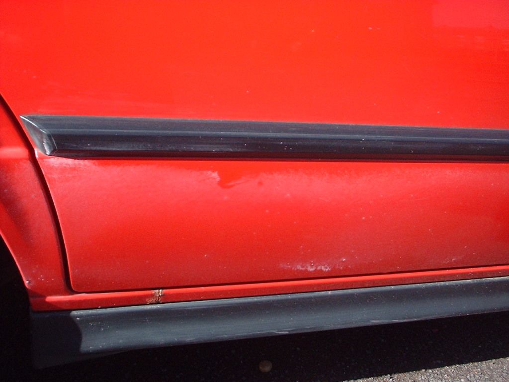

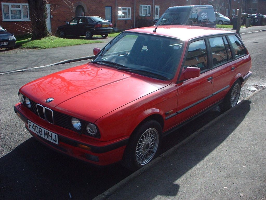

Use neat (carefully) to get rid of minor scratches or with a wet cloth to restore the shine to the paintwork.
To give you an idea of what it can do here is an old 320i I sold for my Dad a while ago after a good going over with the G3 & a wet cloth:
Didn't have any before pictures of the whole car, but this is indicative of how the whole car looked before I started:
