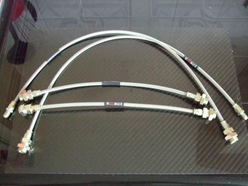

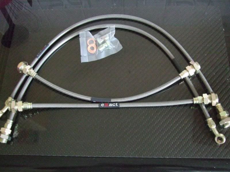

Designed to my own specification and made for me by motorsport engineers EXACT ENGINEERING.
they supply a large number of motorsport teams both in the uk and abroad, they also supply a number of other companies who rebrand and pack them as there own.
Hose ends are made in mild steel in house to there own specification, prior to being galvanisd.
Kits are available with color sleeves for protection and looks for the small price of £1.25 extra per line

brembo 4 pot kit,
rest of saloon range

Those ones for the V6 Coupé's Brembo callipers are wrong. They need to have a short length of tubing with a sharp 90 degree bend at the calliper end.
These manufacturers all seem to copy other manufacturer's pattern parts instead of the genuine Peugeot parts, and they ALL have it wrong as a result.

they dont need to have the metal pipe on at all.
some suppliers use a standered conventional union that goes in straght on the caliper, we use a banjo end with an angle on it and a bolt through it.
the angle throws the hose away from the caliper so it doesnt rub on it.
the same brembo caliper is used by a number of other manufacturers and they all have the hose coming directly from the caliper with out the RIGID pipe.
we have supplied around 10 sets of this design of hose now and have had no problems

Ahhhhh Ok I misread your post and thought the bottom image referred to the V6 Brembo jobbie. I'm with you now and it looks like a smart solution to the problem...
If I hadn't replaced my hoses last year I'd certainly gvie these a go at the price...
Aye, but they don't use them on cars designed for tiny lucas (i think) callipers :lol: The addition of the Brembo things (iirc it's a re-painted calliper designed for Porsche) was a right hack job by Pininfarina, as the hose fitting is pointed inwards towards the wheelarch lining, which means a nasty 90 degree bend is necessary to avoid smashing the pipe through the wheelarch liner and get it all the way up to the union with the body pipe...
