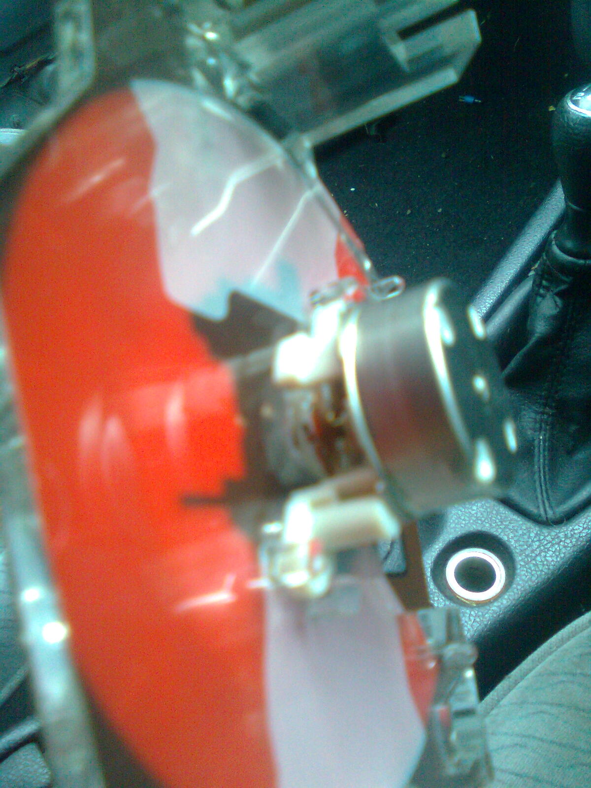

Dismantled the new clocks and removed the needle, then jumped in the car and sat it on the rev limiter in first and pushed the needle on pointing at the right speed. :)

That's what I did exactly and it now reads right :cheesy:
There's a small white plastic wheel I could hold and adjust the needle
And after testing it wit a sat nav, I have it calibrated the way I want :)
