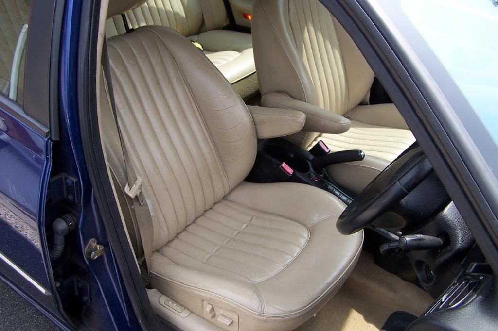

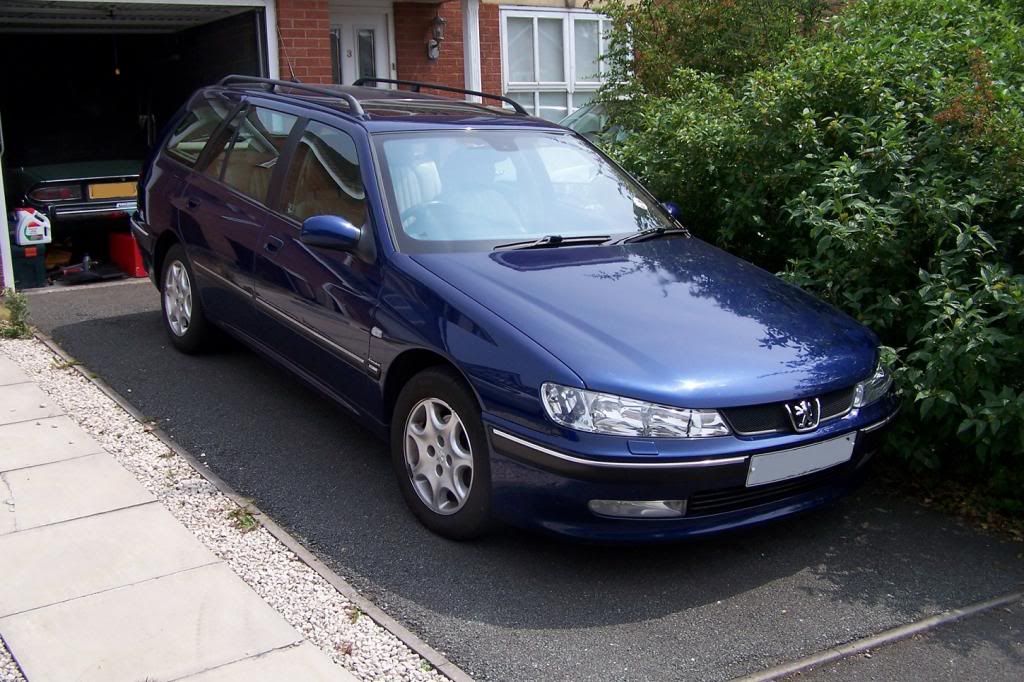

Nice colour and the same interior as mine.
Really low mileage and very tidy too.
Definitely time to introduce M. le Fap to a large hammer and chisel.
If you can, arm yourself with 4 M8 x 40 stainless bolts + nuts in case you have to cut the originals off, (as I had to last time).

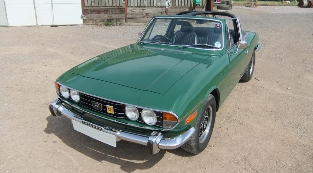

Do I see a Stag lurking in your garage?

Yes, that's my Stag. It's quite a nice one, without being so perfect that you're scared to use it.
The best thing about it, though, is most definitely the noise it makes!

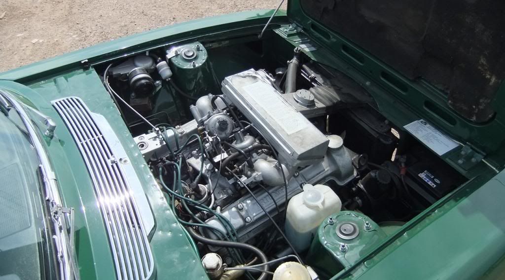

Looks gorgeous, I really, really wanted one back in the late 70's. A TR6 was as near as I ever got.
Still on the original V8?

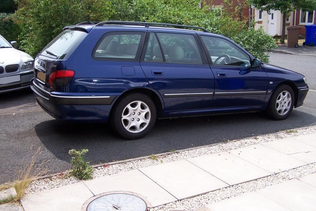

these blue estates are getting very common around here.

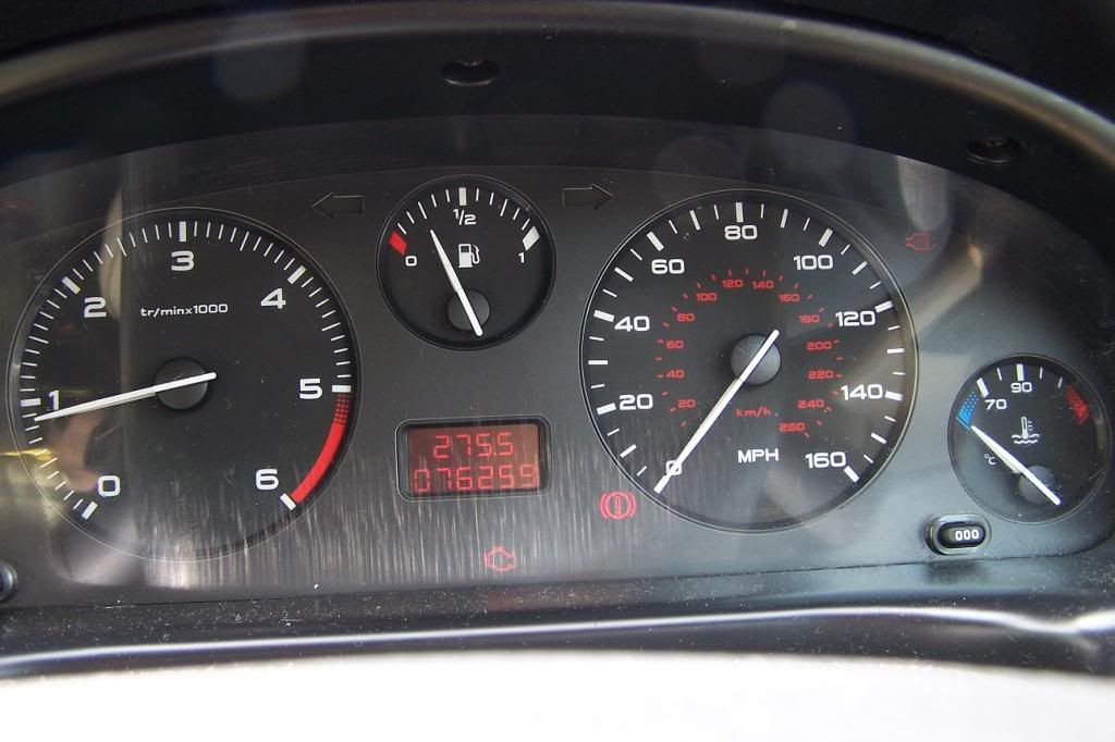

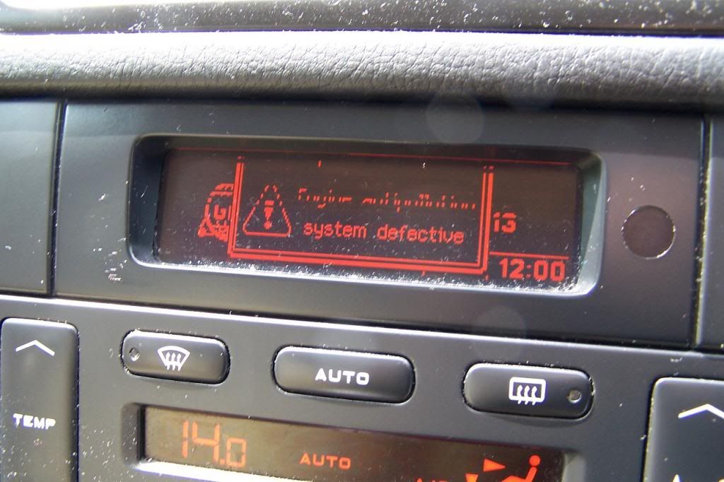

that's the first time I've seen the anti pollution warning on the mfd it looks like it would scare the bajesus out of you.
Very nice looking Stag there too
unlike our resident eagle eye Doggy i didn't see it, nor did i see the bimmer hiding behind the hedge.

Well how about that. I've had this one for about 2 years now, and now I really want a TR6!
Yes, it's still on the original V8...
The bimmer was my everyday car until I got this Peugeot. It's a 330i automatic, which is a tad expensive to run.

Good idea about borrowing a remote, though it might be worth getting hold of one permanently. Those Type C displays are stupidly expensive from dealers, but they do pop up occasionally on eBay from time to time. I saw one go for £80 a couple of months back.
Very nice car, you'll enjoy it a lot more once it's out of limp mode
If you were wondering, that message on the display says "Engine Antipollution System Defective".

Maybe the galletto cable is fried. I assume it's just a serial/usb converter inside the connector?
I bought it from a uk seller through Amazon, so at least I have a fighting chance of obtaining a replacement if it is faulty.
The car still runs, so I don't thing the ecu file is corrupted.
Pete.
BTW, my e-mail address is my 406oc user name at hotmail dot co dot uk
Re: Diesel particulate filter?
Thanks for the info, Jon.
I'll be on the lookout for a replacement display and remote.
The particulate filter is being removed today, then I just need to get my galletto working...
Pete.
Pete.
