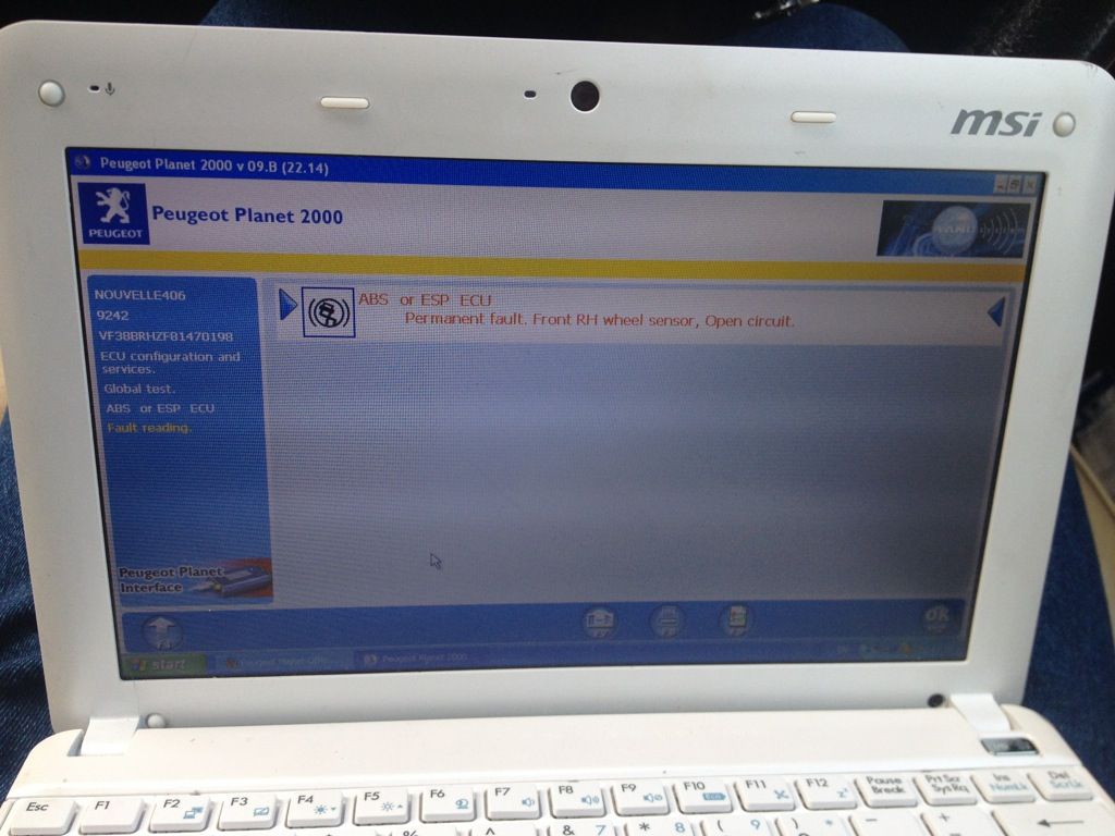

I got the ABS light there the other day before the MOT test and up to the test i was able to get rid of it by disconnecting the battery waiting a few mins and connecting it back up, but now the light is staying on, and pp2000 will not clear the fault:
I took off the RH front sensor (on the drivers wheel), cleaned it up and the reluctor ring on the driveshaft, both of which were quite dirty, popped the cleaned ABS sensor back into place and still the fault remains.
When PP2000 refers to RH does it mean from the perspective of someone sitting in the drivers seat (making RH the drivers side) or someone standing in front of the car facing the bonnet (making it the passengers side)?
Also is there a resistance that i should be looking out for off these sensors?

But does anyone know where PP2000 refers to, when it says RH, is it the passenger or drivers side wheel?

RH is driver's side.

I'd think it does indeed mean as you're sitting in the driver's seat but after Highlander's coil numbering kerfuffle I reckon all bets are off. Hold on, just firing up sedre...
Sedre says so too and it showed the right order for Highlander's coils :?

If you really want a cast iron way of checking left or right sensor disconnect the left hand sensor connection and recheck what PP2000 is reading.

I got into the car this morning and the light has gone, connected up pp2000 and the fault code changed to an intermittent fault which cleared off the system, also doing a parameter measurement for the wheel speed shows that the sensor is now detecting the wheel rotating.
I tried using multimeter, i can see that the voltage, resistance and current all change when the wheel rotates and stay constant when its stationary.
It would appear that the problem has been solved, hopefully.
