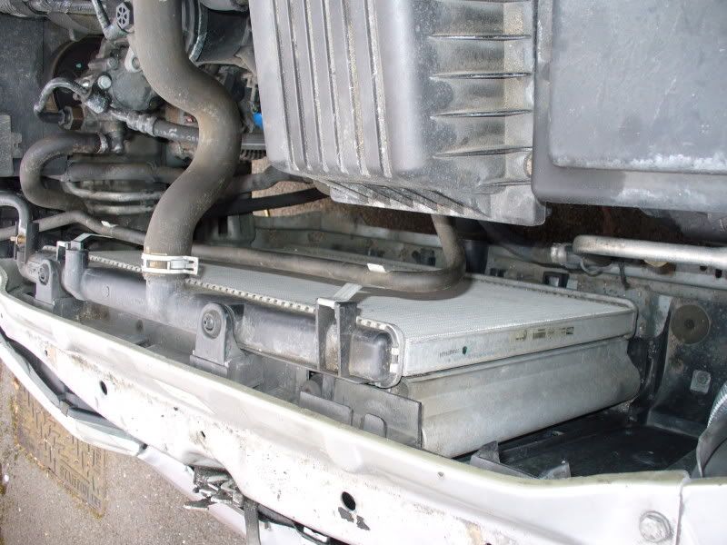

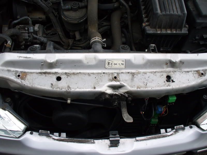

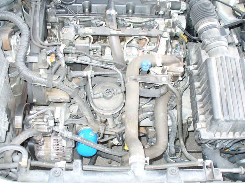

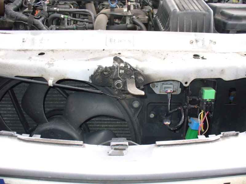

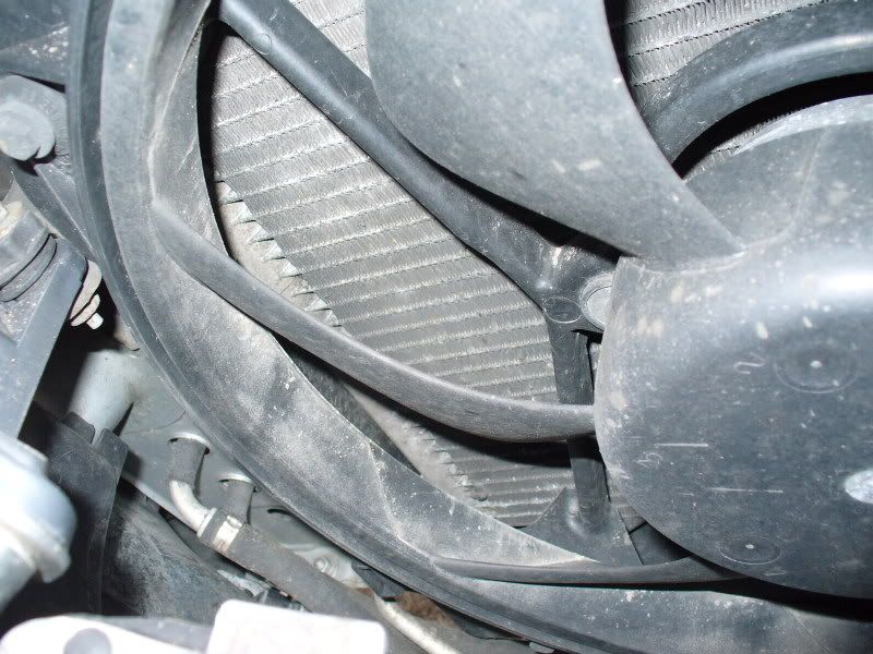

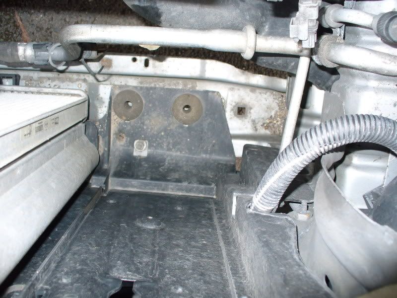

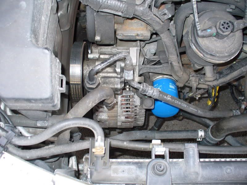

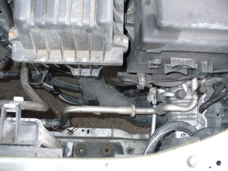

Hi guys
been fiddling with the ol air con again
still not working :(
The air con holds pressure (checked with the pressure guage on the refiller can)
Here are some pics can people point out whats what so i can fiddle with it, is the low pressure switch on any of my pics
Thanks!

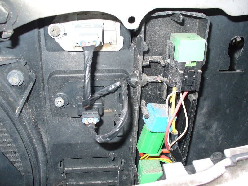

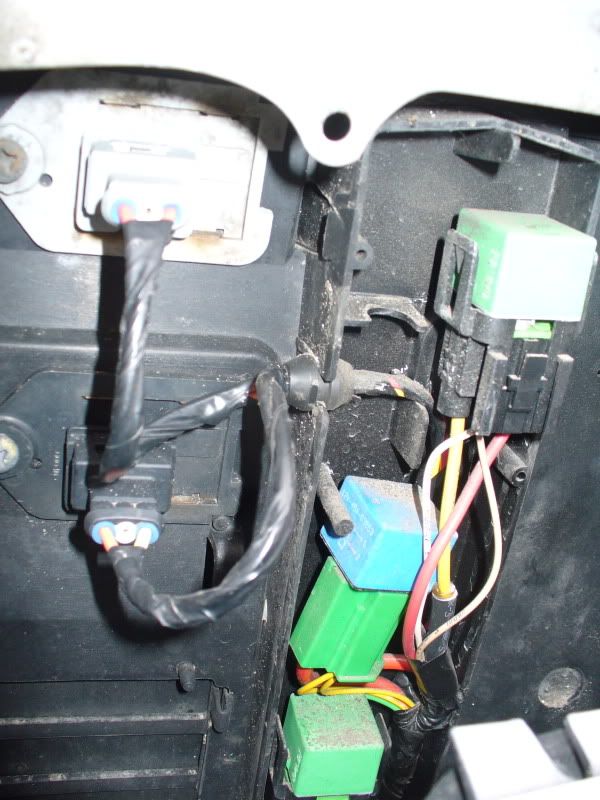

you could take both of these out to see if the coils are broken
look down here and you will see the wiring connector on the top of pressure swictch
try wriggling it or even remove to check for contact quality

Re: d9 air con help needed (pics included)
Yes i think it will release all the pressure , try finding the connector first
then start car turn on ac then go and wiggle connector to see if compressor
engages. you can safely remove the circled items as these are electrical coils ,
check for break in the coil.
