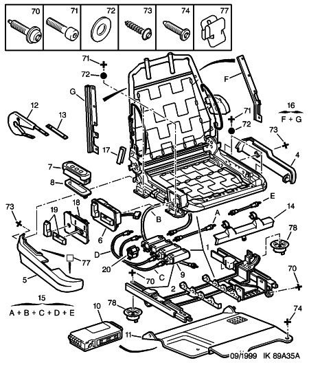

Here's the ServiceBox diagram If you want any other related info let me know 8)

The base op had a look last night and he seems to think that it's cable operated (resembling a push bike brake cable) and the wire has snapped inside the sheath. He thinks it may be possible to bodge with a length of brake cable wire :shock:
Re: HELP!! Electric seat not functioning properly
Hi soops , after consulting haynes book of confusion it looks like its part
driven by a cable which looks like an old fashioned speedo cable with square
drive , and the tilt for the back has got a splined shaft . The cables are held in
with 2 clips so maybe one has pulled out :shock:
There's a set of 5 cables:
00008920Y9 BOWDENWIRES SET £46.37 up to rpo 0 8245 8920 FV (4) (with memory):shock:
00008920FT BOWDENWIRES SET £59.48 since rpo 08246(with memory):shock:
00008920Z0 BOWDENWIRES SET £81.31 (without memory): :!: (look the same)!
There are 4 gear/motor units:
00008920FN SEAT MOTOR £168.38 (with memory) :shock: :shock:
00008920V5 MOTORREDUCER £107.43 (without memory)
I can't see any clips or similar, so assume they're part of the above.
(This bit's guess work)
Rearmost motor = seat backwards / forwards
Cables for front 2 motors look the same = cushion up/down front + rear
Therefore 2nd from back = backrest tilt - this one shows 2 cables, like they connect to the seat at 2 points, maybe one's come off?
Reckon your best bet is to canabalise a seat from another car, service box gives different no.s for estates, but I can't see any difference.

(Or set the passenger seat up and then "borrow" a cable from that side?) :supafrisk:

By the way, it is a cable, it is hanging underneath the seat and is only attached one end, you can see the wire hanging out.
